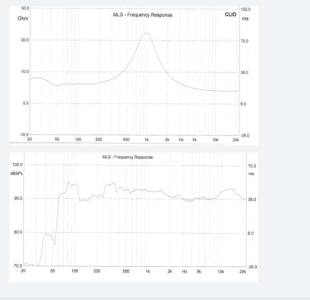

I have the Peerless 10" that is rated at 86 dB.  I was looking at getting a Burro that is 92 or a Dayton woofer that is 90dB to try out.

Hmmm, this is going to be an interesting boondoggle.  Not much for measurements on the web, and I would have to measure them in place to set things up right.
