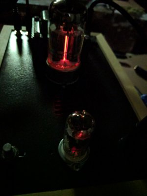

Sorry for the train of thought posts. We're golden though!
Trombone Shorty (For True) and Steely Dan (Aja) on repeat through my HD650 😍😍
