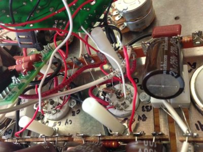

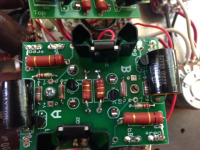

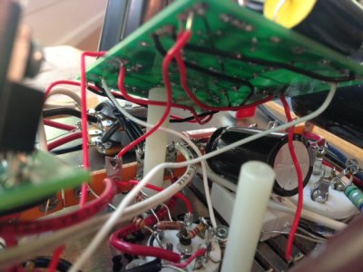

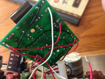

Offline kgoss
    • Posts: 331
Reply #6 on: June 28, 2017, 04:32:35 AM
Post a picture of the board - top and bottom.  Pictures plus voltages is the best and fastest way to get problems resolved.

Offline denti alligator
    • Posts: 1156
Reply #7 on: June 28, 2017, 04:50:41 AM

Last pics taken with IA wire disconnected (only way to get a good shot of the underside)
    • Posts: 1156
Reply #8 on: June 28, 2017, 09:34:45 AM
Went through everything a fourth (!) time, and found the problem!
I had reg+ for A and B sides mixed up. The reason for this is partly (mainly!) because I wasn't being careful enough, but partly because I was reading A and B *down* the side of the board instead of as halves of the board. That is, I confused where to draw the board's "half," because I was looking at the other A and B markings on *that side of the board*.  (Maybe something to stress in future manuals?)
