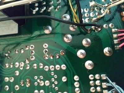

Anyone know how to test a capacitor with 4 leads?  It is the power supply capacitor in a integrated amplifier (soldered to a board).  Thanks,

that's probably two capacitors in one package. test each one separately.

Funny thing about the cap though, is that is looks like 2 of the leads aren't connected.  Only 2 of the leads have traces going to them..  The solder joints for the caps are the diamond shaped patterns in the attached picture.  Oddly enough the other 2 are soldered also  :P  Does that make sense?

Yes it does, the extra leads are just attachment points for a stronger mounting. If look closely at the label they are probably marked in some way...John
