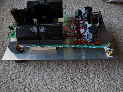

Since the noise level is changed by the volume control, the noise has to be entering at the volume control or before it. Can you post pictures of your build?

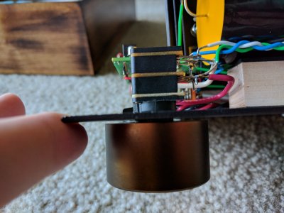

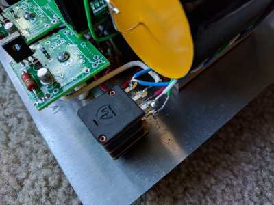

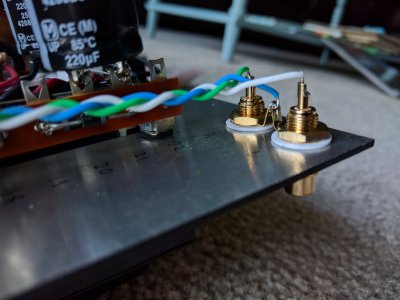

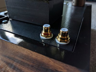

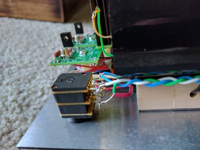

Reply #4 on: October 05, 2017, 05:49:41 AM

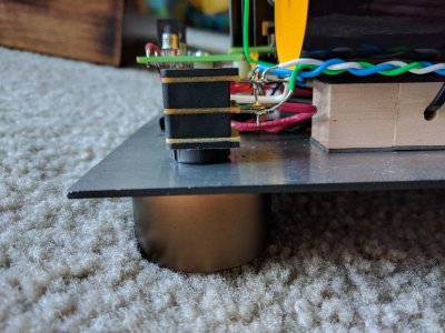

Hi Josh, thanks for taking a look at this, I appreciate it!
Here's a few angles of the RCA jacks and volume pot. The RCA jacks are insulated with white teflon (I think?) washers on both side of the chassis. The volume pot is and Audio Note 100K pot which has a plastic housing so I think it's fairly well insulated.

Offline fullheadofnothing
    • Posts: 1487
Reply #5 on: October 05, 2017, 06:54:22 AM
Could you please post your pictures to the forum? When making a post, there is a section below the text box that says "Attachments and other options".
Speaking personally, I do not click on download links from strangers.

Reply #6 on: October 05, 2017, 09:04:07 AM
Sorry didn't see that button, I updated the post
    • Posts: 20296
Reply #7 on: October 05, 2017, 10:00:11 AM
I would try using the stock pot.  Plastic is not generally as good of a shield as most metals.

Thanks for the help, ordered a stepped attenuator and that fixed the issues I was having.
Interestingly, even though the pot housing is plastic on that attenuator it was introducing noise when touching the chassis  :o
