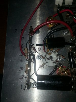

I am attaching a picture.

Here is a better pictures
    • Posts: 20258
You should go through and trim all those component leads that are sticking out in various places.  The lead coming off the back side of terminal 2 has very high voltage on it.  If it dips down a little and touches the chassis, bad things will happen.
Terminal 2 being 61V indicates that you have very strong emission from one half of your 6922, and you may find that this voltage increases a bit as you use the Reduction for several hundred hours.
I would add some solder to 4L, as it doesn't look super well connected.
If an LED on the 9 pin socket isn't lit, you can measure the DC voltage at the pin where it connects to help determine what might be going on.

I trimmed the components and re-soldered the Terminal 4 connection plus the other Terminal 1-8 connections. The LED still does not light up.

What voltage do you see at A2?  I also see some stray leads around A4/A5.

I think I found the problem the resistor 1.0uf 50v Z5U is melted/broken from the RCA ground to  A4.
I will get a replacement and retry.
Thank you for your help and patience.
    • Posts: 9773
That's a capacitor. Do replace it. It's not clear if that will solve all the issues, but it's a step in the right direction.
