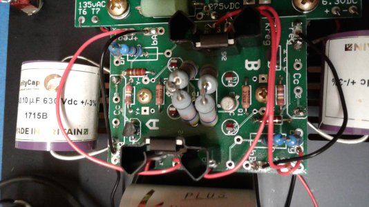

After 3 or 4 trouble free hours over the last couple of days I noticed a tiny blue flash from the vents to the left of the 12BH7 when I switched it on today. I immediately shut it down, took it to the bench, looked it over and ran through the resistance and voltage checks. All good.
No blue flash at restart but the growling in the sub was back for a few seconds before it settled down.
I just happened to be adjusting the volume when I heard a pop, saw smoke and it went quiet. The transformer was hot, not too hot to touch, but hot. The 12BH7 continued glowing for the few seconds it took to switch it off

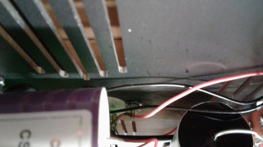

Back to the bench. No components look obviously smoked. The only thing I see is the wire that goes from D6 to IA on the C4S board is scorched. Not at the connection, at one of the bends visible in the photo.
The wire had gotten behind the standoff when installing the SR board and I had snaked it around pretty severely to get it headed back where it belonged.
Does a compromised or broken internal wire here explain the noise, the heat and the sudden quiet? Should I keep looking up stream?

Reply #6 on: October 28, 2017, 09:40:23 AM
Yeah, if that connection isn't there, you'll sure get some noise!  I would just replace that piece of wire.

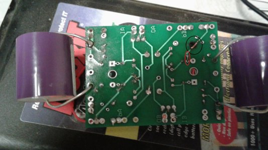

Well the what is solved. The photo shows the trace from the +reg to the Rc exposed and the 110K R4 resistor joint smoked. I realized when I built the board that I soldered in a hole closer to the b reg, but looking at the trace I thought it was ok as the path was the same. Too much voltage or too hot a solder joint close to the +reg /Rc trace? Maybe that's the why? I guess I'll be talking to the Queen about buying a new board.
PS. The long end on the Rc in the red oval isn't touching the open hole leading to the LED, it's just the view.

Post a picture of the top of the smoked hole (it's hiding under the resistor in the top-view you already posted).
Any chance you forgot to solder that joint?  That could cause the arcing, and the arcing (and higher resistance of a bad connection) will generate a lot of heat.

It was soldered, my bad was soldering it in the wrong hole of the board trace, too close to the bottom layer trace.

While the wider holes might have helped, I don't think there's anything wrong with the holes you used.  (They appear to be there in case you want to use a thick-film resistor.)
Before ordering a new board you could put the resistor into the other holes, remove the damaged portion of the trace on the bottom (with an x-acto knife, for instance), and then solder a wire between the two holes at either end of the trace.
