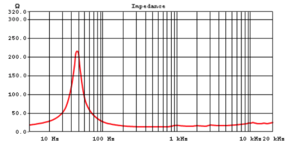

Thank you for your input. Is there a DC heater option for the original Stereomur? I have been looking for that but not been able to find any. That would solve the problem.
As for the output impedance my full tones are 16 Ohm. It would still be OK to wire them for the lowest impedance?
Yes.  Driving a 16 Ohm speaker on the 4 Ohm setting provides a lower noise floor, better damping (bass control), reduced distortion, and reduced power.  All but one of these characteristics is desirable.
