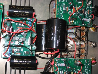

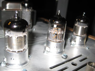

So thanx again and i bought unmatched pair for output coupling 1mf Murdof afterall. I also changed the 0.1mf. And brand new tubes from TAD, TUNGSOL, JJ !! Very nice result and looking forward to even better.
