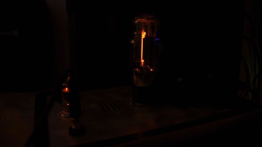

Hi
Yesterday i got a few Svetlana NOS 6H13C tubes.
After using it on my Crack about 2hours straight without any problems i took a little breather and turned off my amp.
1 hour later i turned my amp on again and started to listen it but this time after 5 minutes the 6H13C tube got two blue glowing spots on the glass either side of the tube.
One of the spots occasionally starts to flare up and down and everytime it does this i can hear buzzing sound from my right headphone.
Is this normal or should i swap tubes?
I did'n notice this phenomenon with 6080 tubes.
Before this i used a Sylviana 6080 tube and it has worked well at least 3 weeks.
--Jesse

Reply #7 on: December 16, 2017, 12:01:49 AM
Blue glow is definitely on the glass not on the element itself.
I think this tube is bad, because this blue glow is far from normal (at least i think so).
1. blue glow moves
2. you can hear noise (from headphones, not from the tub it self) while it moves
3. this i learned yesterday, blu glow it reacts when you touch the glass
I have 2A3 tubes wich all glow blue on some degree, but none of them has these three symptons.
I'm gonna discard this tube, but i'm stil very interested what could cause these symptoms.
So if you have more suggestions please post them.
Jesse Kolu

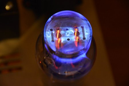

Here's the glow I had and I replaced the tube.  There was a midrange "grunge".  It's also quite possible the blue glow had nothing to do with the grunge, might have just been a bad tube.
Aaron Luebke
Reply #10 on: December 16, 2017, 12:31:08 PM
Perhaps the glass glow indicates that the electron cloud is abnormally shaped. I'm just speculating, as I haven't really noticed a correlation of glass glow and noise myself. Might be worth compiling a history of people's experience with tubes with glowing glass.

My blue glow isn't as intense as in Aaron Luebkes picture.
Mine is more like two dots on the glass 180 degrees of each other (in picture you can only see one and it looks more like line than dot).
I also think the blue glow isn't cause of the noise it's more likley a symptom.
Jesse Kolu
