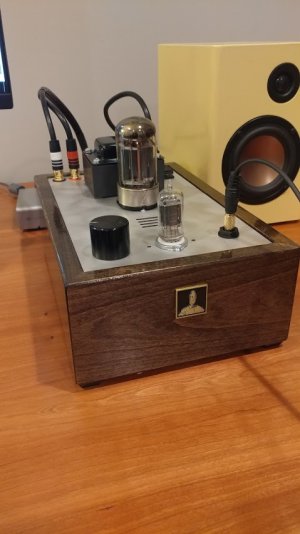

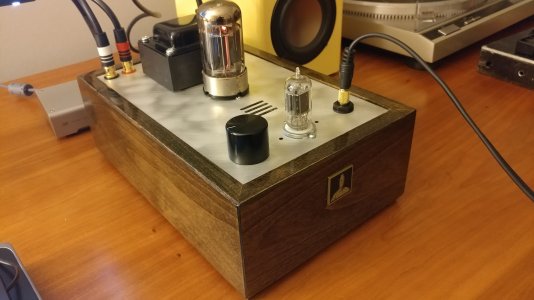

So I built my Crack about 3 weeks ago and have been enjoying it immensely.  Thought I would share some build and listening impressions.
First of all the instructions were fantastic.  I've built a lot of audio related kits over the years and these were some of the best instructions I've ever come across.  I'd say it took me about 6 hours with a couple of breaks in between to wire everything up.  Add on about 30-45 minutes of troubleshooting nasty hum that turned out to be a cold solder joint  on the ground for the headphone out.
Now, on to the wood work.  I was dreading this part. I have zero experience working with wood and thought I would most definitely screw something up.  The cabinet assembly was very straight forward and took about 15 minutes.  The finishing on the other hand took a solid week to get it to where I was happy with it.  Once the cabinet was assembled I borrowed a random orbital sander and sanded with a 220 grit pad.  After a lot of reading, I decided to go with an ebony Minwax stain due to its availability.  I also got the Minwax pre-stain treatment and Minwax poly for the clear coat.  I found the pre-stain to be very effective on some old pieces of 2x4 I had laying around from when my house was built, so I would highly recommend that for any n00bs like myself.  I applied the ebony stain very lightly, and wiped it off quickly.  Surprisingly it came out half way decent IMHO.  Much more dark brown than ebony which is what I was hoping for.  After waiting 24 hours I began applying the poly.   I did 3 or 4 coats of poly waiting 24 hours between each coat.  After the first coat I did a light sanding with 300 grit sand paper, but I did not do that after the 2nd or 3rd coats.  All in all I am pretty happy with its appearance.  Oh yeah I hit the bell cover with 2 coats of gloss black Krylon and it looks pretty good I must say.
A couple of other changes I have made initially were to use an Alps Blue Velvet pot and a new knob to accommodate the longer shaft of the Alps.  I rolled the dice and bought an Alps pot from a Chinese Ebay seller and I think I lucked out.  It very well could be fake but I checked resistances before installing and both channels were very closely matched.  I listen at fairly low volume so this was important to me.

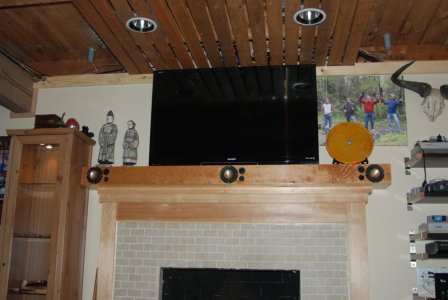

I ended up making a soundbar based on that design:
That looks awesome (as does that impressive looking rack of gear to the right). :o. I imagine it sounds as good as it looks. Is it integrated into the mantle or did you replace the mantle with the mega OS sound bar?

I like how you found the sweet spot in three weeks, RCA clear top and a 6H13C.  You can spend a whole lot of money chasing rare and interesting tubes and never find much of an improvement.
...those speakers are crying out for a S.E.X amp :P
Offline kgoss
    • Posts: 331
Reply #6 on: December 15, 2017, 03:57:37 AM
Great job finishing the base!  The pre stain or sanding sealer step is the key to getting an even color on open grain wood.  A lot of people skip that step and end up with a blotchy finish with dark spots where the wood grain absorbed more stain.  For someone with no woodworking in their genes you did an outstanding job!  The amp and base both look great, enjoy the fruit of your labor!
