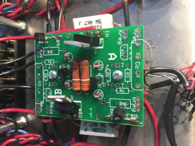

I recently purchased a used Stereomour, and have been reviewing its build against the assembly instructions before powering it up.
The LM431's seem very out of place -- see attached photos.
I wanted to see if anyone recognized any good reason for them to be installed as they are, before I remove them, get fresh LM431's and rebuild the board to match the assembly manual.
Let me know what you think.
John

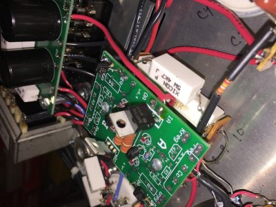

Reply #1 on: December 18, 2017, 09:15:15 AM
One more image

Reply #2 on: December 18, 2017, 09:20:48 AM
That's a Stereomour I.
Thread moved to legacy products.
It's also using PN2907s  vs. 2N2907s. That's a pretty good clue that this amp was worked on by PB and he wired the board in a way that simplified layout (i.e. uses fewer jumpers).
Assuming that the amp is working, there is no good reason to rebuild a board in a working amp.
« Last Edit: December 18, 2017, 09:24:41 AM by fullheadofnothing »

    • Posts: 20290
Reply #12 on: December 18, 2017, 12:28:04 PM
Yes, that looks like a Stereomour that was likely in for repair, which received a new C4S board.  The manual calls for the TL431 to be installed differently with a bunch of wire jumpers, but the arrangement on your PC board is functionally identical.
I'm not sure how to answer your question about the board itself.  The PC board has two C4S loads and enough extra pads that it was a convenient place to locate the 431s.
I'm not aware of any complete resource on all of the possibilities for wiring up that board.  There are so many different possibilities for what you can do with the combination of the C4S load and the voltage regulator that it would take some serious time to document!

Reply #13 on: December 18, 2017, 01:30:07 PM
If you look close, you will see that the board is Version 4.4. For a long time I tried to make the same board do many different things, because there are large economies of scale if you buy many boards at the same time. It's a tradeoff, lower price vs. easier to build.

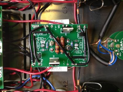

Reply #14 on: December 21, 2017, 04:17:34 AM
John,
I am still using my original Stereomour and here is a photo of the same v4.4 board wired as per manual.
Boris
