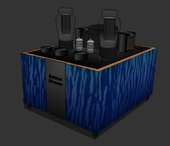

I built a SEX3.0 with C4S that I have used with them, and even at 2.5w rating I got about 95db at the listening position,about 2.65m, at 10%THD(from my graph it looked like almost all second order) and got up to about 98-100db before really noticing the soft tube-style clipping. Needless to say I am a huge fan of the SEX3.1 with C4S. I sold the SEX as that was the purpose behind getting it was to build it and sell it for a profit. We are in the process of adopting from India so I started building audio gear to help with costs.
Perhaps I can save some money by getting a submissive sex combo (again insertion loss should be negligible since my sources could easily drive the SEX to clipping) or maybe just use a SEX3.0 with my FPIII. I am getting enough tiger maple board feet I could actually build matching bases for both. Attached is the design idea I had for the SMR2 that I could change up to the SEX and FPIII or SEX/submissive.
