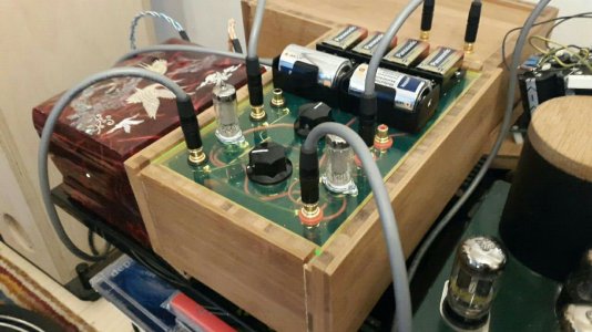

Used to run Seduction couple of years ago and wanted to get some of that tube heat again here to heat up the cold Finnish winter days...Jokes beside I'm running couple of fully modded and beefed up chip amps. A pair of Musical Laboratory Maedeup Gainclone loaners (Dutch company long gone by now. the jewelry boxes in the pic) and Diy TI tpa3116 chip mono amps with silver inductors, Lundahl ll1540 transformer inputs and so on... So i wanted to try some tubes in front of the to warm up the sound. I've been using Pass B1 and Salas DCB1 with good results but last summer i got a loaner tube pre and that combo really hit the nail in the head. So the decision to get a tube pre was made and with past experience with bottlehead stuff and quick check around the web and wallet rounded the options to Quickie.
Chassis plate is see through green and it sits on diy butyl dampened bambu base. That and cork-rubber footers keep the ringing while walking or tapping the hifi stand almost non existent. Only other up grade at the moment is Cardas multistrand wire in signal path.
PJCCS is still waiting in package and other up-grades on the way too, at least caps, pot and i have some nos Mullards waiting too.

Final jury is still out for the sound, but i can say of the bat and still burning tubes and all in, that it sound great for the price of it. Highs are clean, natural and all there, midrange is great, natural and full, bass is only area that has trouble, its little shy in lowest region and little smeared in all bass region. But i'm hoping that burn in and up-grades bring some help in the bass. But still it is what it is and being realist it won't deliver all the goods even with up-grades, thats what its bigger brothers are for. But i'm sure i'll be happy with it until it's time to up-grade to one of it's bigger brothers.
Put in the Mullard CV820's and can hardly get any ringing of tubes, i have to tap really hard on chassis plate to get some ringing and it dies out really fast. With no dampening of the tubes, just cork/rubber footers and butyl plating the base

Which prompts a guestion....What is the mechanism here behind the microphonics, i don't understand too much of tubes but seems that there is too ways to tackle it here. Mechanical damping and or using it as cathode follower. Do these address the same "problem" from different angle or what happens here.
Just being curious mechanical engineer.
Sound wise the Quickie is so good to my taste that i haven't had any thoughts of upgrading to anything else for a while, but this is just in my "low budget" carefully with thought assembled diy system.
-Tatu-
    • Posts: 5907
Reply #8 on: September 19, 2018, 05:53:02 AM
What's happening is vibration of the interior elements, changing the spacing between electrodes and therefore the electric field. It's usually more severe with directly heated filaments, which are thin wires.
With the common-cathode (normal) circuit, the grid-cathode variation is amplified by the gain of the tube.
In cathode follower, there is no gain, and the smaller noise is further reduced by the negative feedback.
