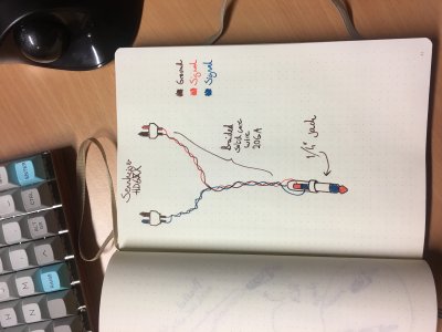

I'm planning two wires:
  • 1x 1/8" jack to RCA cable
  • 1x 1/4" jack to Sennheiser HD600/650/6XX headphones
I've been scouring the web for information but I must admit that what I've come up with is based purely on imitation without understanding (monkey see, monkey do) so be prepared for ill-informed questions.
Both cables will consist of four solid core 20GA wires, insulated (not teflon):
Two for signal, two for ground.
Both cables will be covered in simple techflex.
  • Both cables start with one plug and end with two plugs, is there any advantage to first making a four-wire braid that splits into two two-cable braids or can I just have two braids all the way?
-two-cable braids are waaay easier than four-cable braids!

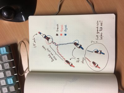

The 1/8" jack cable will go from my source to my amp.
  • Does braiding the signal and ground cables act as some sort of shielding?
  • Should I cut the ground cable before they reach the RCA plugs?
-something about avoiding a "ground loop"?
This is not a good plan. Solid core is only to be used in places where it will not be subject to physical stress/bending (i.e. internal chassis wiring). Headphone wires/interconnects/speaker wire should be made with stranded wire.
• Braiding the wires can help reject noise, but it is not a shield. Braided copper or copper foil can be obtained if you find you need a proper shield.
• If you use a shield, you can choose to only attach it to ground at one end (which may or may not improve its noise rejection). If you are only using the two wires. You must connect the ground at both ends.
• I can't think of a single time I have glued a plug and not ended up regretting it later. YMMV. Its not about audibility of the glue, but solder joints can fail, or sometimes you want to re-purpose connectors.
All in all, I consider slapping some ends onto microphone cable the best way to construct interconnects. You can get shielded if you like, and virtrually every problem you have envisioned is avoided.

Reply #2 on: January 03, 2018, 03:58:21 AM
I  went through some deliberation regarding solid core vs. stranded.
And I agree with you, stranded is without a doubt more flexible.
But a few DIY guide I found used solid core (silver in most cases) and since my cables will sit relatively still in my office and solid core i easier to work with, I decided to go for solid core.

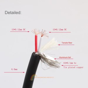

Can I use a shielded cable like the included image for the two cables I want to make?
Do I use the two wires inside for signal and the shielding for ground?
Or do I use two cables and use one wire inside each for ground?
-that will be one fat ass cable.

The 1/8" to RCA cable is a bit of a complicated one to tackle.  I would use 6 conductors and solder two each to the tip, ring, and shield of the 1/8" plug, then do a 6 wire litz braid for most of the length of the cable, split off 3 and 3, then do a standard braid to your RCA plugs.  Techflex and cable pants can help hide a mistake or two along the way.  As Josh mentioned, if you make this out of solid core wire, you're going to get to make it again later with stranded wire.
So 6 separate wires? What thickness should I go for, 16GA?
Yeah, while 2 wires would be enough to get the job done, you can't braid 2 wires, and if you twist them the cable may lay kinda funny when you're done.  16GA is more than adequate, I'd look for some 20AWG teflon jacketed stranded wire.  There's usually a lot of this available on eBay.

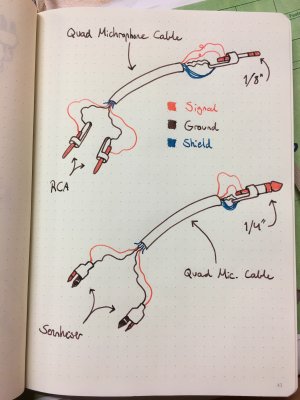

Okay, I'm intrigued by the use of microphone wires.
I read through your forum posts (yeah, you guys definitely seemed familar with one another ;D) and think I've got the general idea.
You solder some of the shielding with the ground wires on the jack end, is that right?
-I've made a sketch, does it look about right?

Sketch looks correct.  I use a portion of the shield only because using all if it is a royal pain.  It requires more heat and if I remember correctly only the Cardas has room for all of it.
If you noticed some of the comments from the latest thread over on that forum - plan before soldering!  That includes size and position of heat shrink and getting the components threaded on the wire before you make the final soldering.  Oh...and over three beers is not recommended.  It appears that two drinks is max.
Yeah, I should just have listened to you to begin with.
I almost feel like I owe you a slight apology!
