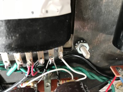

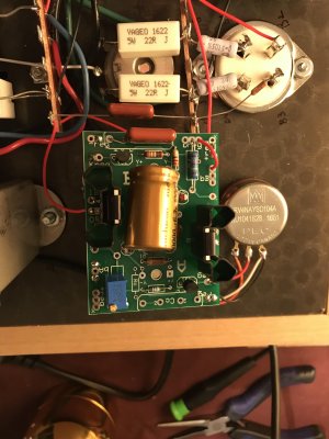

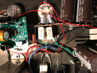

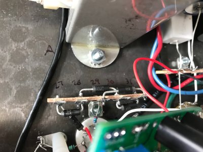

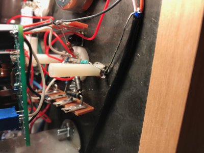

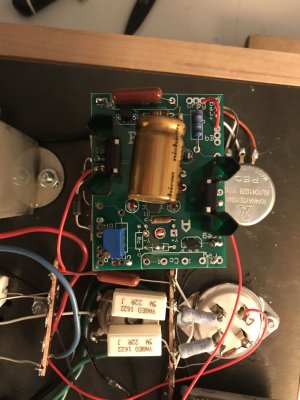

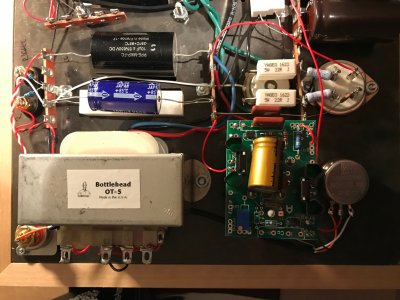

Pictures attached.
Thanks for the help!

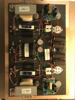

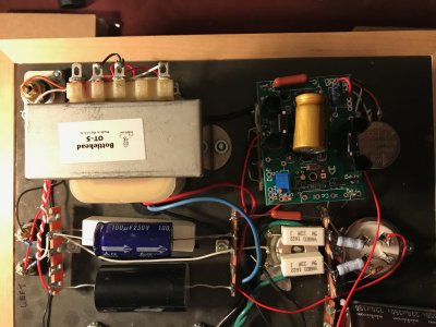

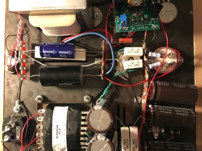

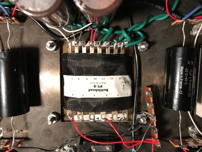

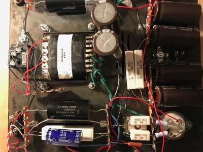

Top level shots
Offline Sawgolf4me
    • Posts: 23

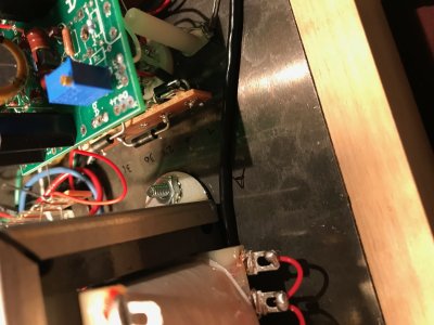

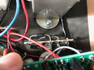

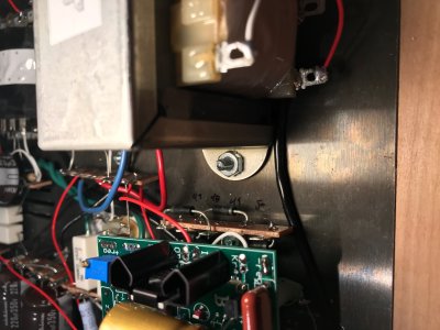

Reply #14 on: January 11, 2018, 02:24:18 PM

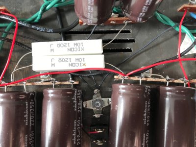

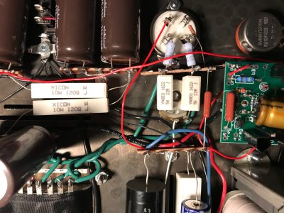

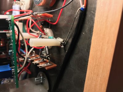

Close in shots
