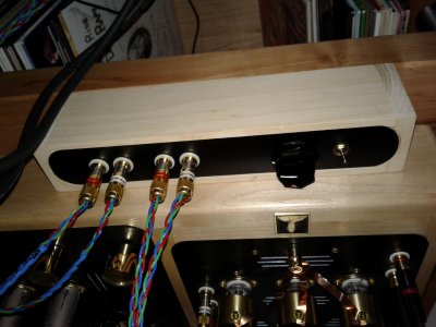

Finally got around to a workaround. I built a little RCA in/out box with an Alps pot. Now I can fine-tune the input to the Cocktail X12 by first finding the highest level on the album and adjusting the pot accordingly. Seems to work fine. (I didn't use the Quickie as it is upstairs, mounted in the same enclosure as the Seductor)
