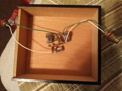

Hello, I recently built a Fix choosing the setting that seemed most appropriate with my speakers. I used Silver Mica caps and a mix of wirewound and metal film resistors.
The sound is very different from the polystyrene's used in the kit. There is more high frequency extension and faster response. The downside is the polystyrene's used in the original kit had a very warm sound. Also I wont be able to switch between settings as in the original fix.

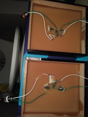

Potted the device in urethane gel and put it in a cigar box.
