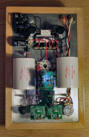

After building a standard Crack + Speedball I have only upgraded the output caps.
 I'm very pleased with the results over the last couple of years but would like to investigate to possible improvements of power supply upgrades and recommendations of replacement caps.
 Are the improvements in sound worth the time and effort.

Thank you for all the replies and sorry for the delay in returning a post. I decided to keep the Crack as it was in the photo, it sounds great and has never played up. When or should i say if i have problems that maybe the time to revisit this.
