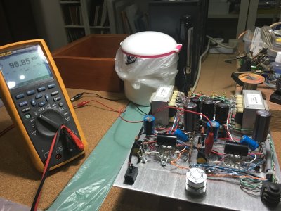

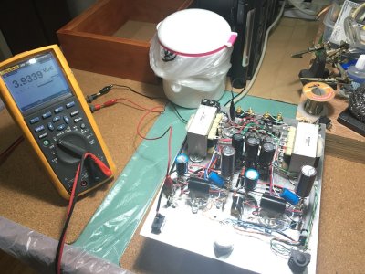

I tried power up the unit to check the Vdc and I got the following reading.
- Terminal 2 : 3.9Vdc
-Terminal 16 : 96Vdc
I suspect that one of the tube may be faulty, as both resistance and voltage reading at terminal 2 is out. I have swapped the the tubes and I got the opposite reading.
That just confirms the resistance issue.
Did the problematic voltage move to terminal 16?

Yes

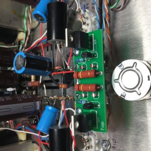

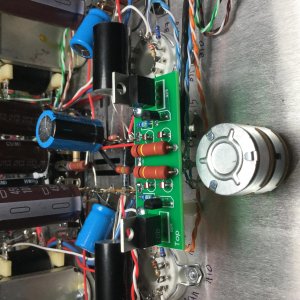

After installing the C4S, voltage measured at terminal OA : 126Vdc & OB : 146Vdc seems higher than the one indicated in the manual. Do note that i have two different brand tubes installed (GE & RCA).
Regards
    • Posts: 20297
Reply #6 on: February 21, 2018, 04:13:35 AM
You have neglected to complete one of the steps when installing the C4S board.  Please review the instructions on page 15 of  the C4S installation manual.

Wow...Thank you for the quick replied. I have clipped the 150K resistors and re-measured terminal 2 @ 68Vdc & terminal 16 @ 89Vdc now.
