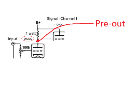

I have attached a picture to try to clarify what I got the idea from, maybe I just have a fundamental misunderstanding? I assumed I would need a capacitor to get rid of this DC component in my signal.

Yes, signal can be taken from the plate of the 12AU7 as you've drawn, but the DC needs to be blocked (with a cap) at some point.
The input impedance of whatever buffer you use doesn't have to be that high.  200K should be high enough.
You know, the output of the Crack is already cap coupled and you could just feed a pair of opamps from there to drive your meter.
