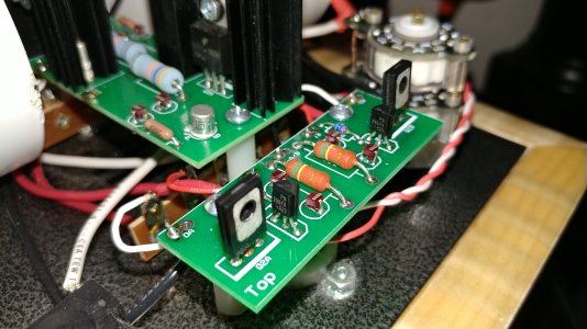

I recently upgraded my potentiometer to a DACT CT2-2. My amp sounds fine but after the upgrade I noticed that OA on my Speedball board gets a low reading. It's possible this issue existed before the DACT install.
Small PCB
OA: 50V
OB: 78V
1A: 176V
1B: 176V
Large PCB
OA: 70V
OB: 90V
G: 0
B+: 176V
Where should I start looking for problems? I've tried to spot any shorts on the PC boards and reflown a few suspect solders joints but no luck.

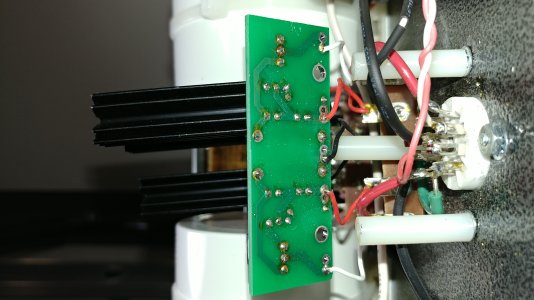

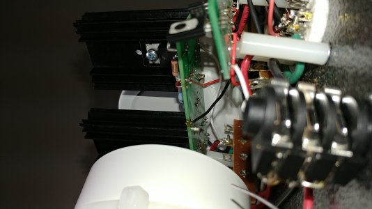

I see solder wicked up onto the top side of the board on the PN2907, is that solder connecting two legs of the PN2907?
Offline jimjitsu
Reply #2 on: February 15, 2018, 12:10:55 PM

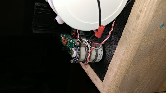

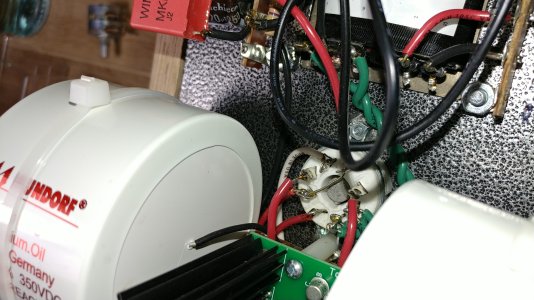

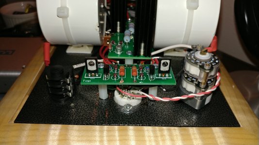

That may have just been a bad angle for the photo. Here are a couple other photos that might give a better view.

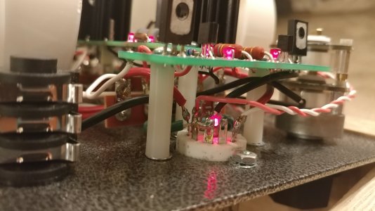

Offline jimjitsu
Reply #5 on: February 16, 2018, 03:15:41 AM
I just noticed one of the LEDs on my 12AU7 socket is not lit (center to A8). What would that indicate?
« Last Edit: February 16, 2018, 03:37:30 AM by jimjitsu »
Offline jimjitsu
Reply #6 on: February 16, 2018, 04:06:25 AM
Got it! Removed the LED between the center pin and A8
 Connected a cable from A3 to A8. Now it passes all voltage checks perfectly. Thank you for the help!
