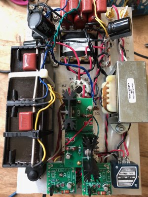

Offline TravAndAlex
    • Posts: 16
Picture in case it helps.
    • Posts: 9790
Are you hearing hiss or hum? The choke could be introducing hum. When you change the layout as much as you have it gets quite difficult for us to give you a definitive answer of what could be causing the problem. Returning the amp to the stock layout might be a good starting point, then add each mod back one at a time and listen to see what is causing the problem.

    • Posts: 20297
I'm not quite the expert on these things, but I have some reasons to believe that your volume pot may not be authentic.
Our recommendations will always be to take things back to the stock configuration for debugging.

    • Posts: 20297
your voltages are all just fine.  This is most likely a flaky solder joint in the amp somewhere, though I have seen loose hardware also cause random noise in one channel.
I have also seen this happen once in a while when the jumper between the two ground lugs on the volume pot is missing or not well connected.
