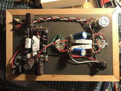

What voltage do you get at terminal 13?  Can you post photos of your build?

Here's a picture of my build.
After I read your comment, I noticed that the 270 Ohm 5W resistor wasn't soldered in with the rest so I just resoldered terminal 13U with the resistor end connected. I will redo my resistance and voltage readings right now and give you the numbers again.

So after I resoldered it, the resistance checks out and both LEDs are now lit!
