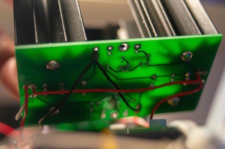

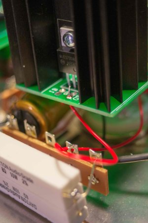

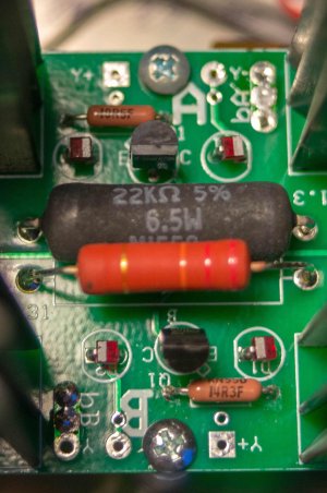

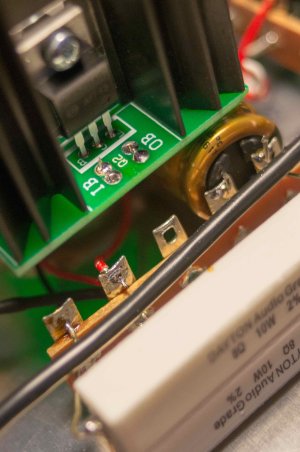

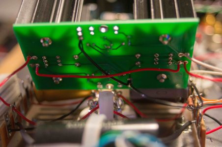

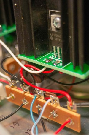

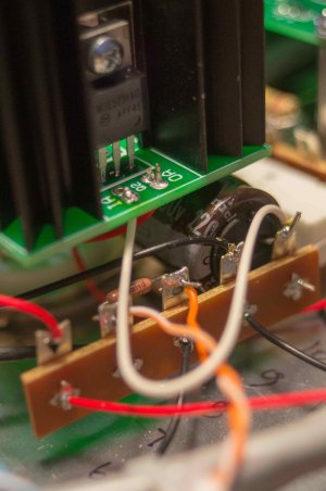

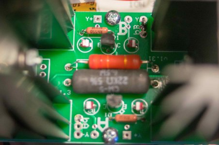

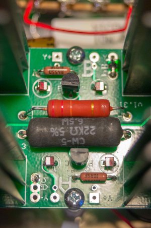

Here are some photos of the build, all around the 2 boards top and bottom as per your request.
Let me know if you need additional photos.
ike
Reply #5 on: March 01, 2018, 06:41:31 AM
The first thing I notice on one of your photos is that I can see a wire soldered to an "OB" pad but the insulation is visible poking out of the hole.  That wire is essentially connected to nothing.
I also see long legs of PN2907 transistors poking through the boards.  Those should be trimmed close to the board so that it's nice and easy to see that there aren't legs shorted together.
Lastly, a lot of the connections I see on the terminal strips are just component leads passing through the terminals with solder over them.  We recommend at least bending the lead up so that there's a better mechanical connection.  Optimally, these would be bent up and around the terminal if possible (which isn't always an option on the lower terminals).  Without connections made like this, it can be difficult to tell which components may be loose.
Reply #6 on: March 01, 2018, 07:24:13 AM
I will submit that the issue may be a need for a magnifier to see if the solder joints are good or not. There are indeed several connections in those closeup images that look like they could use a reflow and a bit more solder. I use a visor magnifier.

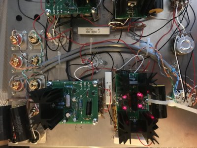

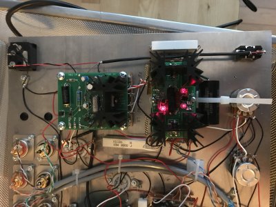

So, I re-soldered all the connections with a hotter iron. After that, I turned the amp on and no LED light on one board, a step backwards. Thought, the other had all 4 LED lights up, first time. I re-soldered the side that was not lit and I have 3 out of the four LED up. Here are the pics. Any other ideas?

I re-solder some more and took more measurements... Now, the board closest to the power switch, none of the LEDs are on.
Reply #11 on: March 09, 2018, 11:16:35 AM
If it was on my bench I would look at every connection around that PC board with a magnifier. It sounds like you had one bad connection and have created another when reflowing. Running continuity tests from one end of a connection to the other can sometimes help spot a cold connection.
