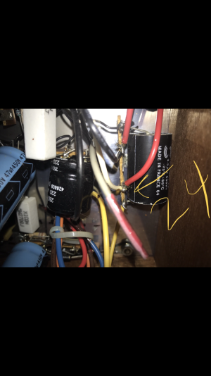

 I’m 90% sure that it’s already set up for 8 ohm.
 My disconnected (heat shrunk) wire is gray not yellow.
Pretty clear that white is hooked up to terminal 24
 Here’s a picture if I can figure out how to post...

Looks good.
The gray wire might mean we had already changed over to the Speco output transformer - it's been a dozen years, and my memory wasn't that great to begin with! In any case,it was a nice trip down memory lane to figure this out.  :^)
