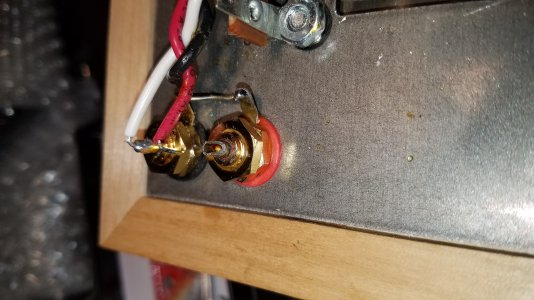

Ok... I popped the center wire back out.  Center pin to ground (12U), with meter set to 2M (I don't have an autoranging meter) starts at 1.3M area and then increases to off the chart (ie., 1 reading on the meter).  Center wire to ground (12U) is reading 97k.
Photo of center pot attached

Well... I must have had a bad joint... For the hell of it I just resoldered the center wire back in again, and am now getting 90k.  Go figure.
Apologize for wasting people's time... thanks
    • Posts: 5907
Reply #6 on: March 06, 2018, 02:22:02 PM
My guess would be that there was a bunch of solder flux in the RCA socket. Flux can be slightly conductive, and soldering those center pins can take a lot of heat and solder. And (in case anyone wonders) that's an experience-based guess ...
