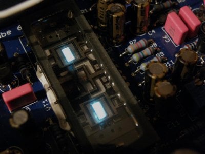

I figured that this site would have good perspective on this mini tube, if you will. It is not so new now, but being a DHT, it made me pause when I saw it, and immediately, I wondered who might have any experience with it, or an opinion on it. I believe that model is SP1, but not sure. Sure there are kits out there to configure it to different tasks, but who cares if it doesn't measure up in terms of sound quality to begin with?

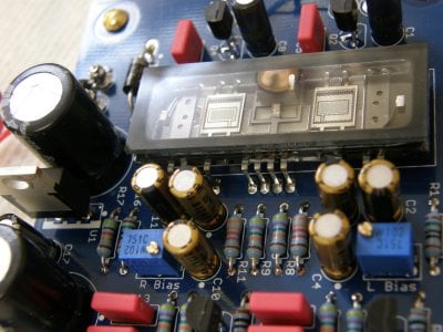

Reply #3 on: March 21, 2018, 07:54:59 AM
 Just an update. Got the 'tubes' up and running last night. This certainly a different animal. When I bias the tubes according to the spec sheet (2.5 volts) it causes severe clipping, so I have decreased the bias to 2.04 volts. That is still within the spec of a 1.7 volt minimum. Now that is the case using a 12 volt battery. I plan to try an 18 volt battery since it has some effect on the distortion. I have added a volume control to the input, as it seems that a CD player input is a bit hot. The setting that the volume control provides is at 4.7/4.5 kohms.

Reply #5 on: March 24, 2018, 01:25:54 PM
FWIW, I did find the information needed to adjust the bias. It is stated that it becomes a matter of preference. Distortion is more present setting the bias towards 2.5 volts, and less likely at lower bias settings. Also, my experience has taken me to lower the audio input signal a bit so that there isn't the tendency to overdrive the circuit. About 8 db down to start with, and using an 18 volt battery supply, I am getting a feel for better results. Regardless, I also get the feeling that this circuit may be more suited to guitar pedal effect, or some thinking closer to that than audio in an audio system per se, as we use in our homes.  I will try for a bit longer, and appreciate the opportunity to experience this product.

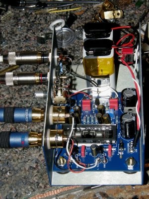

 Here is a shot of the enclosure stuffed with the Nutube circuit along with batteries.

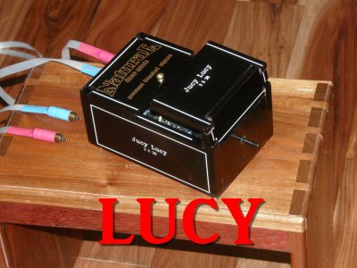

Reply #7 on: April 10, 2018, 04:29:33 PM
 Here I am at the end of the experiment. I have listened to the unit and found that with the sound, it can vary, at least from different sources. i mean to say that the unit is overwhelmed by CD input, and so a 50k volume control is used to deal with that. The computer input however is fine for it, and sounds better to my ears. The bass is increased, which serves my system nicely. The treble is a bit soft, and that may just be my hearing. I am trying to ring out as much these days as I can when it comes to music, knowing that there was more to it all even 5 years ago. Aging sucks. Finally, I will add that I like the mid range, since it is fuller than without the unit in place. I feel it necessary to add as i have in the past, that these results in the system that I own, and probably would sound quite different in other systems. So that is all for now, at least until I make time to complete my Quickie/fix project.
 this is what I ended up using for the enclosure.
