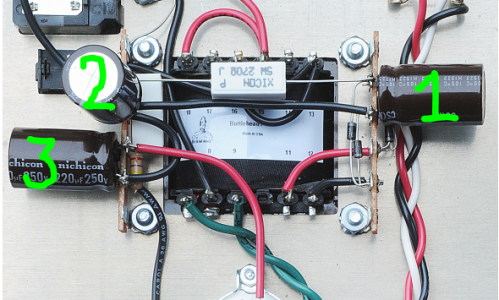

    I've also read that the biggest benefit would come from swapping out the 2nd and 3rd cap, but which terminals are those connected to?
    20U and 21U? 1
    14U and 15U? 2
    12U and 13U? 3
    The attached image shows the order of the power caps!
  • Again it is best to find caps with matching ratings, 220uF and 250V?.

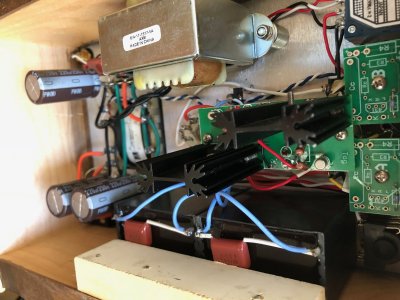

  • Does one use film caps here as well? That sounds like it would be impossible to fit alongside the Speedball and output film caps and perhaps a choke.
    Yes, it is pretty much impossible to fit replacement film caps on the PSU and outputs.
    This reddit/Head-Fi user has replaced the last lytic cap with a film cap.
    With a choke in place of one of the PSU-resistors (the big rectangular white ones between 15-21U and 13-15L) he was able to put a 100uF film cap in place of the last resistor.
    While replacement film caps are tough to fit, bypass caps are much easier.
    Find some 2.2uF 250V film caps like perhaps these and solder them in along with the electrolytic power caps instead.
