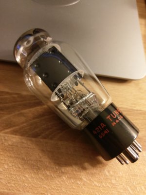

I've picked up this oddity in its place, a Tung Sol 421A, can't be many of these around  ;D subjective listening tells me this is a 421A, not a 5998.  To new beginnings!

One of the things that distinguishes the 421a variants from the more regular 5998s is they normally have they clear tops.  If you do see tubes labelled 5998 with domino clear tops they will be early ones around the 1950's fwiw I think these are the best of the bunch . While they all have the domino plates there are a number of variations of the internal structures and getter positions that have changed over time.

I have seen the clear top 5998's but have never owned one myself.  I have owned five different 5998's, they all sounded similar to me, but one stood out, had a slightly different internal structure (thicker, longer copper colored rods on the sides of the heater filament, as opposed to thinner, shorter silver rods on other 5998's I've owned) and sounded closer to a 421A.  The TS 421A pictured has both top and bottom getters and it does sound on par with my Western Electric 421A.  I'll have to keep my eyes out for a clear top :) could pair with my incoming Crackatwoa, planning to jump in on the sale and will likely do a build log as well.
