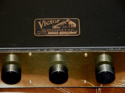

  The idea of coarse and fine volume works so well in my headphone amp. Should have done this years ago. Mine is a bit different in the way that the coarse volume controls both channels, where as there are two other knobs (fine volume), one for each channel. Try explaining THAT to someone. I just say, "Let me do it."
