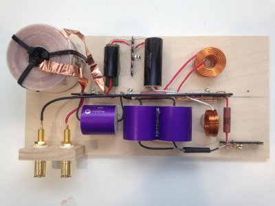

     Considering PB and PJ's comments, perhaps you guys will eval this coil arrangement.As I said before, I don't think I have ever had a problem, but if you don't measure the interaction or try several arrangements and compare, how would you know? For scale, board is 6"x12". The large foil inductor is about 8 inches from the smaller aircores. This is the first time that I have put both woofer and tweeter components on the same board ( due to space considerations). This puts more coils in proximity to each other and thus, my concern.

The large foil inductor has the same axis as the small one at the far end of the adjacent long side. It is possible to orient three with mutually perpendicular axes. The 8" spacing is too close to rule out an audible difference without testing it.

     I'm not completely sure, but I think PJ was referring to the coil with the white shrink. This definitely has a problematic orientation with the large foil inductor, but since it is almost nine inches away I'm hoping it doesn't effect things too much. I hope PJ will let me know for sure if that's the one he was referring to.

The one with red wires has the same orientation as the foil inductor, and is close enough to be  a potential problem - IMHO.  If you put it on edge (like the white-wire one is) with the axis pointed at the one with white wires, they will all have axes perpendicular to each other, which should minimize interactions.
Whether the difference is audible, or produces a clear preference, can only be determined by experiment.

Well, I guess this is my chance to make those comparisons I was talking about.Since this xover will be mounted externally, changing things will be easy. I'll change one now and see if there is a difference between the two once I have them up and running.Thanks to all for your input.

I could not tell a difference between the xover with the reoriented aircore  and the one with the axis parallel to the large foil inductor. My hearing may not be what it used to be, so if any difference exists it isn't apparent to me. I think I will change "wrong" one though, just to keep things consistent.(maybe 8 inches was enough?).
