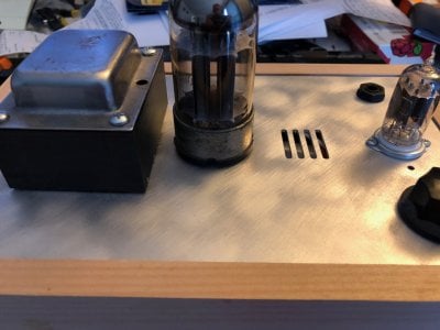

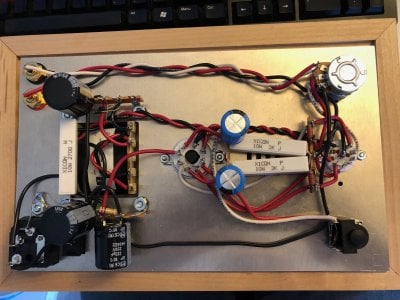

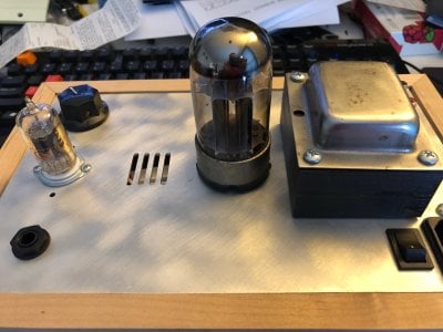

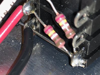

Ok, see attached.

Are the 6080s pins clean? One possible scenario is oxidation buildup on the tube pins and/or the socket contacts over that year that the amp sat unused.
Reply #9 on: April 02, 2018, 05:33:19 PM
The untrimmed lead coming out of 19L looks like it is shorting to the other UF4007s. Even if it isn't it is a hazard that should be fixed.
    • Posts: 19699
Reply #10 on: April 03, 2018, 04:01:46 AM
I'd also recommend reheating the solder joints on 3U and 3L.
