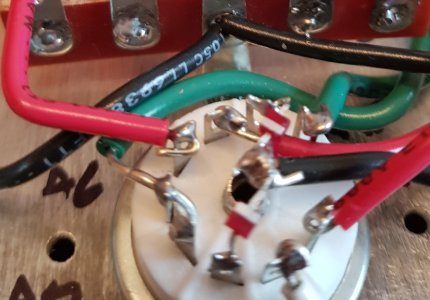

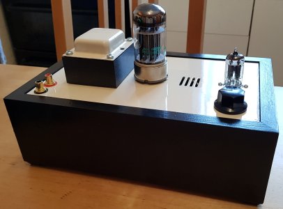

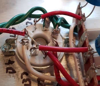

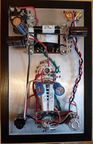

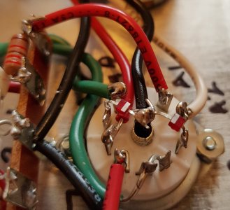

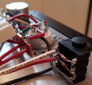

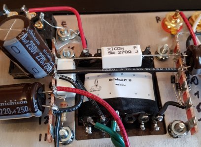

Reply #4 on: April 01, 2018, 11:27:30 PM
Here are some pictures for you, let me know if you need any specific areas.
    • Posts: 20300
Reply #5 on: April 02, 2018, 03:54:45 AM
You missed a step on page 38.
The terminal 12 end of the 270K resistor looks like it might touch the screw at terminal 11, which wouldn't be helpful for noise.

Page 38 was when I went to make a coffee. Though I picked up where I left off, obviously I didn't. I've now put it in.
That resistor isn't touching, close, but there is a gap. Was just the camera angle.
I've rechecked my voltages and they are all good now.
