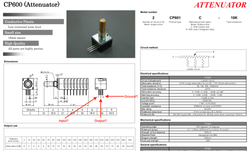

I've ordered a new pot for my Crack, and I could use a hand (brain?) with figuring out the wiring.
I think I've got it, but I want to make sure.
So I'm waiting for a TKD 2CP601 pot.
I've attached a snapshot of the data sheet, I've made annotations in red for how I think it's supposed to be.
1= In?
2= Out?
C= Ground?
Look alright to you?

Reply #1 on: April 02, 2018, 02:29:49 AM
Looks correct, just like the stock pots, but those pins are a little more difficult to solder on. You're going dual-mono?

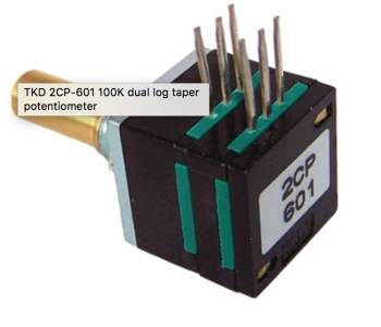

Now I'm going to sound quite stupid, dual mono?
I hope not!
The picture in the data sheet just has one set of pins, the one I'm getting has two sets, so I'm hoping that means it's stereo  :P
I've attached a photo of it.

    • Posts: 634
Reply #3 on: April 02, 2018, 03:16:38 AM
Yes, I was going by the first picture. I have both in my SEX amp. First the stereo pot then later added the mono pot (using only one gang of the stereo) for a dual-mono set up for balance.
