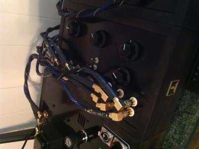

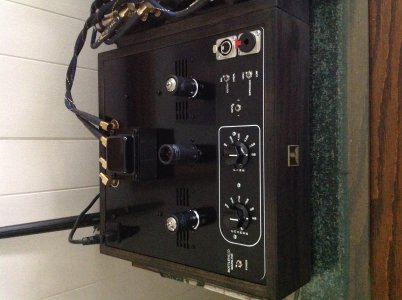

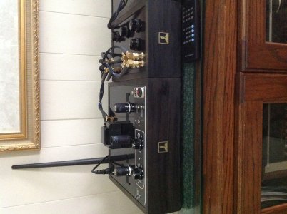

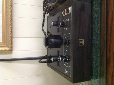

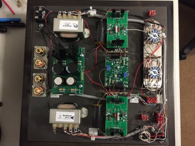

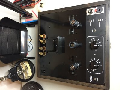

Completed my latest BH project. Adding the Mainline HP amp to my BH family required me to temporarily bench may Crack and S.E.X 2.1 due to available real estate.
This was a very enjoyable project.  I went real slow and spent about 1-2 hours a sitting over several days.
I kept the "black on black" scheme with the same ebony stain for the base.
I'm using my 3 output modded Submissive as my input selector and main volume control.
I set the Mainline controls to 0db and adjust the volume on the Submissive.  There is some minor loss in gain with this setup but I don't perceive any degradation of the audio signal.
This amp sounds fantastic; however, after a longer run down the road I might upgrade the para-feed caps to the ones I have in both my S.E.X amps.

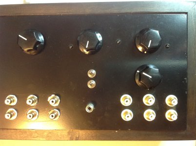

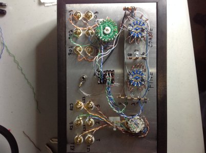

Reply #10 on: April 20, 2018, 03:46:03 PM

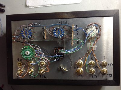

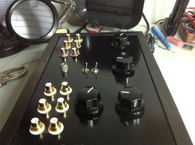

I have completed the installation of the switches that will bypass the attenuator of the Submissive.
I have probably gonzo-engineered this.
I used one 4PDT switch to completely isolate the inputs to the attenuator and another 4PDT switch to isolate the outputs of the attenuator.
I wanted to ensure that when the attenuator was bypassed that there was no remnants of the attenuator.  This may not have been necessary, but I went for it because that's how my simple mind works.
Everything works perfectly.  When selected, the attenuator is just as originally designed.  When bypassed, the attenuator is not in the circuit at all.
One thing that is very important that I must always be aware of is to not bypass the attenuator when sending the output to my Paramounts.  This would send a full-gain signal from the source to the amp .  There would be an instant max volume going to my speakers.  I am curious about the uncontrolled gain that would result but not enough to try it.
What I have left to do is engineer a way to gang the switches together.  I hope what I come up with is simple and elegant.
Here are some pictures.

Offline Adrian
    • Posts: 278
Reply #11 on: April 29, 2018, 11:06:14 AM

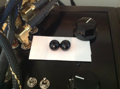

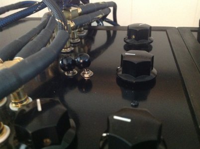

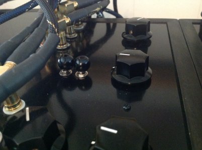

So, I made something that will gang together the two switches that enable me to bypass the attenuator.
Two 14mm wooden beads glued together fit perfectly and made the task simple and elegant.
