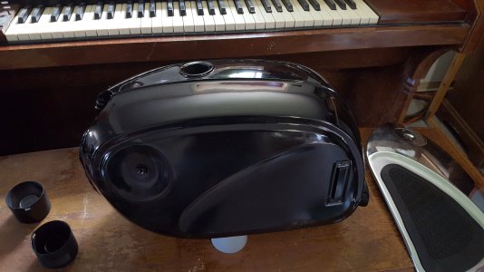

Yes, very good advice. I have also tried as much as possible to adhere to the program of only shooting paint when the humidity is down around 50% or lower and the temp is above 65F. Not easy to find those conditions in the Pacific Northwet. I also warm the rattle can in hot water before spraying, and shake it every minute or so as I lay on the paint.
With Hammerite the trick I have found is to lay on one medium-light and then two medium coats just a couple minutes apart. If the one coat fully sets up before the next is laid on the hammered pattern won't form as well. Luckily with the panel sitting flat one does not have to worry much about sags or runs, so one can err on the heavy side.
Though the common opinion is "rattlecans suck", one can do a decent job with some practice. This tank was done with rattlecans.
