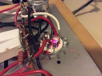

The LED between A8 and the center connector is not lighting up. This should be lighting up, correct? I attached a photo

The wire at A5 is not soldered well.

Yes, as I said before, I would reflow that joint at A5.  It's not all the way soldered.
