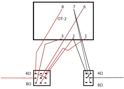

I ordered the MourQuiet kit and I was thinking I would like to have the ability switch the OTs from 4 to 8 Ohms.
Since the impedance matching boards are no longer available I came up with what I think will work. 2 toggle switches per channel, (I was unable to find a 5 pole version.) The only problem I see is if the + switch was on 8 and the other was inadvertently left on 4.
Please feel free to point out my folly or if I'm over-ticking the plumbing.
