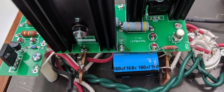

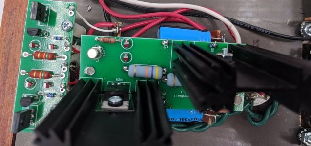

The LEDs were not the issue.  Can you post some photos of your build?  We might be able to spot the issue.  Did you resolder all of the joints on the big PC board?
Offline tjames37
    • Posts: 6
Reply #4 on: April 20, 2018, 10:29:32 AM
I have re-soldered all the joints on my large board 3 times. Ignore the unsolder 0A and B+ I have been unsoldering them to work on the underside.

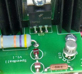

I think I got it figured out. I'm only reading 0.3 ohms across the collector and emitter on the 0B TIP50. Any idea where I can get another? Thanks!
    • Posts: 20295
Reply #6 on: April 20, 2018, 11:09:44 AM
Mouser is a good place to get them.
From the top side photo, it looks like the collector of Q2B (center pin) is not all the way soldered.  That brown-ish/yellow color on the leg is solder flux.  This joint takes a lot of heat to properly solder.
Did you remedy this solder joint?
Your description also indicates that the connection to the 6080 cathode is basically open, so it's just floating up to a very high voltage.  This would be consistent with the solder joint I mentioned.
Yes sir. The center pin is also holding that voltage, and I did a continuity check on the center pin. I am fairly confident the center pin is soldered.

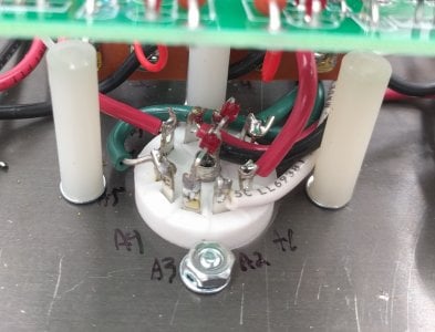

Reply #10 on: April 26, 2018, 01:40:38 PM
Another thing to check would be the wire leaving "O" on that side of the board. If it's broken, that would cause an issue like you're having potentially.
