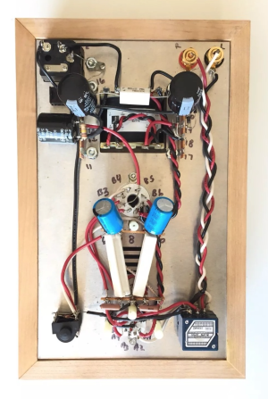

Move me as needed! Here's a basic pic. I can take more angles as needed.

I don't see any pads installed on your Crack.
