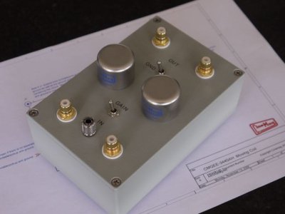

Reply #13 on: April 28, 2018, 02:08:53 PM
Here's an example of an SUT I built using Cinemag transformers & a Hammond project box. These have the threaded bushing mount as recommended. Plenty of other examples to be found on the web.
