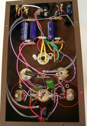

This all seemed very odd until I noticed a pair of trim pots inside SE84CKC.  If you turn these up a bit, your amp will become more sensitive ad there will be no gain issue.

Thank a lot for such detailed description. Unfortunately my technical level is much lower than yours so i am just cannot understand what you mean by "input sensitivity of 200mV is a bit more realistic". And there are no trim pots inside my amplifier (you've found wrong picture - i think this is a preamp because i don't see output transformers inside the chassis). Output tube by default is SV83 (not El84).

Ah, that's what I get for using google images.
There's some extra gain to be had in that circuit, it has likely been optimized to not be overly sensitive when paired with high level sources.  You might want to contact the manufacturer to see about modifications to change the input sensitivity to 1V RMS.
