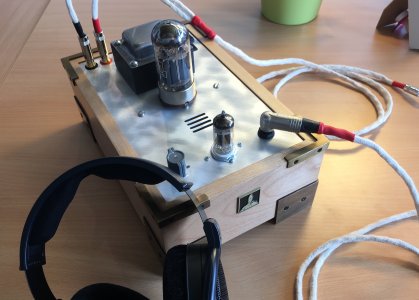

Let me present my, pretty much, finished (for now) Crack:
IRONCLAD
-or Brass Shithouse, alternatively.
Mods:
Speedball
Output Caps: Mundorft MKP, 100uF 250V
Choke: Hammond 157M
Pot: TKD 2CP-601
Power Bypass Cap: JB JFX, 2.2uF 250V
Cosmetics:
Polycoat for base
Clearcoat for transformer bell
Knob: Elma Marconi Classic British Wing Knob from HifiCollective
Brass corners: Heart of Brass Etsy store
Pictured tubes:
Mullard 6080
Mullard 12AU7
-just because they fit the IRONCLAD (capital letters required) theme

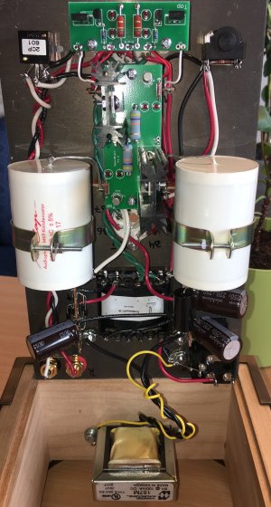

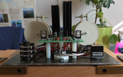

Speedball:
Not much to say, order the kit and stuff it in.
Audible difference: Nicer bass.
Choke:

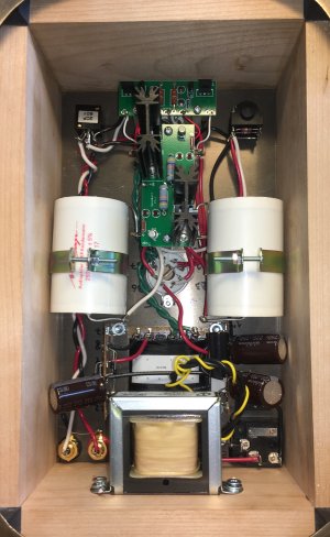

I debated wether to suspend the choke from the top plate or mount it in the base.
In the end I decided to screw it to the inside wall of the base, where I think it fit rather nicely.
I might stuff in another choke just to adhere to the IRONCLAD theme...nah.
Audible difference: Not that I could hear. My Crack was dead quiet before and is still dead quiet.
Power bypass:
The small film cap was cheap so I figured "why not".
Bypassed the last cap in the PSU.
Audible difference: Nah.
Pot:
There was a slight, expected, imbalance at lower levels with the stock pot.
So I figured, "why not".
Went for a TKP pot just because lot's of people go for the Alps.
The stock pot was just as smooth as the TKP, I find the TKP takes a little more force to rotate.
The TKP fits in the plate hole, so no need for filing.
But the “locking tap” makes the pot’s terminals face away from the nine pin socket and it’s considerably smaller than the stock pot, so you might have to choose between running longer wires to and from the pot or figure out how to mount the TKP facing another way.
I ended up putting an extra nut on the pot, so the locking tap didn’t reach the plate. But the pot is still a little small, so my wiring to and from the pot is a mess, gonna fix it up some day.
Audible difference: better channel balance at lower volume levels.
Output caps:
These are probably my favourite.
Not because of the sound, just because I like the look of them.
But soldering the fat leads with a 15W iron was an enormous pain in the ass; took ages to heat up.
They’re suspended below the top plate by metal mounting clamps. I quite like the clamps as they’ll let me swap caps quite easily if needed and they look sturdy.
Audible difference: sorry, can’t hear it.

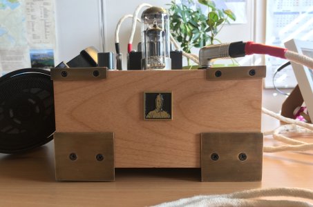

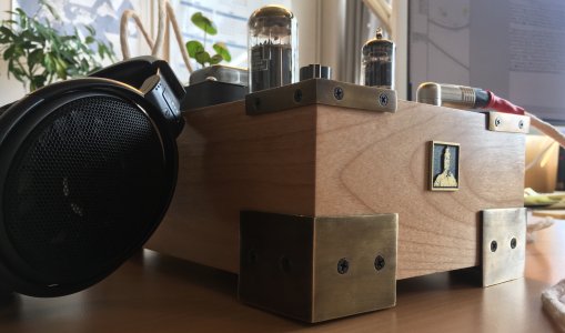

Brass corner pieces:
I wanted some square, metal feet for my Crack.
It was pretty much impossible to find exactly what I pictured so I landed on these metal corner guards that I mounted like legs.
While I quite like the look, the Crack has gone from an intriguing oddity on my desk to a brutal and ostentatious behemoth.
Audible difference: by far the largest sonic improvement of any modification.
