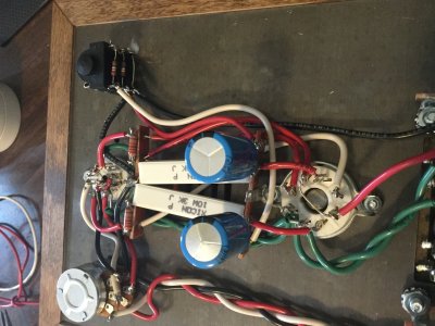

Post pictures.

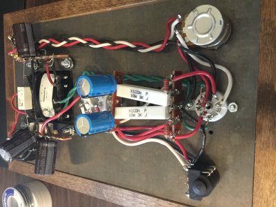

See the blue electrolytic caps on the terminal strip between the 6080 socket and the big white resistors? The one on the volume pot side is in backwards. It is bulged on the end because of this and should be replaced.
