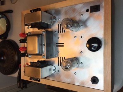

The stock potentiometer on S.E.X. 3.0 looks cool. I am looking at upgrading it to a Goldpoint attenuator.
Does the stock knob gonna fit into Goldpoint? Any suggestions for a replacement knob? I will appreciate your reply.

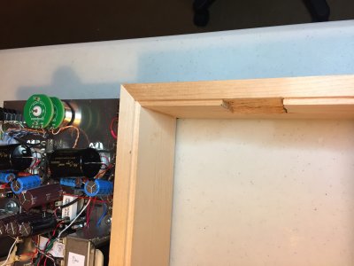

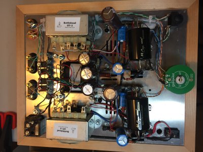

Yes, it fits.
I had to notch out an area in the box for the attenuator to fit.
