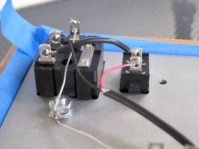

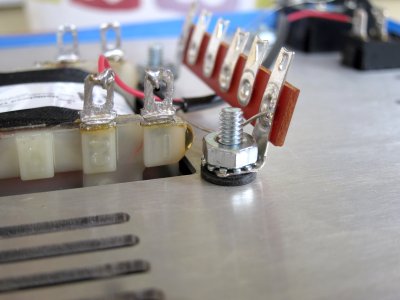

Here are some pictures. I'm going to reflow the joint on the power switch closest to the edge of the chassis

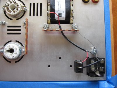

Reply #3 on: May 18, 2018, 09:33:26 AM
Can you take a top down shot from above?
Offline StevePL
    • Posts: 28
Reply #4 on: May 18, 2018, 10:04:03 AM
Here you go.
Crack Speedball, HD600, HD 25 300ohm.
Audirvana +, Schiit Modi Multibit, Smash-Smash Up Clarity MR, Rotel 956 bridged 2x Mono, Revel Performa F30.
Fiio X5ii, Quickie, Quicksand, Blumenstein Orca
    • Posts: 20297
Reply #5 on: May 18, 2018, 11:10:46 AM
With the power unplugged, remove the red wire that connects to the power transformer, then leave it sticking up in the air and retest.
With that wire disconnected, check the DC resistance between terminals 1 and 2 on the power transformer.
