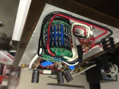

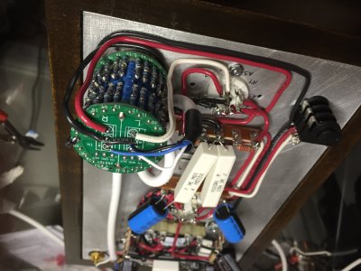

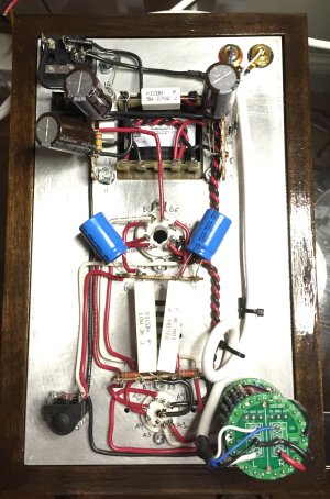

I discovered recently that when my Bottlehead Crack has nothing plugged in (The RCAs,) It produces a noticeable low hum regardless of the position, (with the exception of "0" obviously,) of my stepped attenuator. To clarify, when the RCA's are plugged in, the unit is super quiet and sounds awesome like it always had from the day I finished building it. The unit was built as a stock unit at first, then a few months later I added a stepped attenuator, then after that I added the speedball, finally, I built a shielded power cord with some really nice copper I found at my local electronic surplus store. I'm leaning towards the theory that perhaps the stepped attenuator is at fault here but before I assume things I figured someone here can suggest a quick trouble shooting technique, unless this symptom is normal to the Crack. Again, this is not at all a problem when everything is plugged in and/or while I'm listening to music, the amp is working like it should. I'm attaching some pics of the build in case anyone and catch something weird. Thanks in advance.
There you go, situation resolved. Well done.
Stepped attenuator and Crack in the same sentence means that you have modified the volume control from stock. With that kind of modification comes a certain amount of risk that we can't give a definitive answer to your issue because we do not have experience with the specific component you added. It's not that uncommon for an amp to pick up external hum or other noise with no source attached as they are not designed to operate without a source connected. The fact that the noise stops at the lowest (mute) setting of the attenuator indicates that the noise is external to the circuit. And the amount of noise could indeed be influenced by the parts connected to said input which, in the case of the Crack, includes the volume control.
