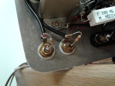

What did you end up using for series resistance between the center pins of the RCA jacks and the inputs of the balance pot?
    • Posts: 634
I used 43K, I'm getting about 95K centered and about 46K and 95K biased.

OK I sure would like to see this.  Karl, could you possibly post a picture of the balance control as wired with the resistors?  And a question for the Bottlehead Braintrust:  if I were to use the AN balance control, would I have to reverse the positions of the volume and balance controls on the Stereomour II chassis?
