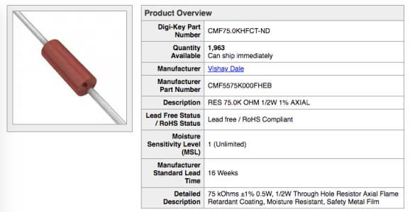

On Digikey, search for:
"CMF55 33K"
and
"CMF55 75K"
They usually have two different items depending on quantity, so if you end up on a page with a minimum of 1000-5000 pieces, that's for a whole reel, and you just need to go back and look for the same item in quantity 1.

Paul - thank you. These look different than the resistors that are used in the kit, I assume that's fine?
Tom - thanks you're totally right, I mis-read it the first time through!
    • Posts: 20297
Reply #4 on: June 13, 2018, 03:53:20 AM
Yes, these are an acceptable choice.
If you search
"CCF55 33.2K"
and
"CCF 75K"
Those will look similar to the 2.49K resistors on the headphone jack.  (I'd rather have the other parts I picked for you)

Reply #5 on: August 20, 2022, 04:03:30 AM
Hoping I can resuscitate this thread. I’m having the same issue with sensitive volume and want to install these resistors. However, I’m overwhelmed with the number of choices on Digikey when I search the keywords Paul mentioned. Would anyone mind linking me to the exact resistors I should be buying?
Thanks in advance!
